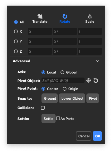

The new Rotation tool/modal is crippling me at the moment. It is quite fiddly (when you “lock” an axis, the model locks to the movement of your mouse with no button clicked. And the biggest issue I am having is that I can no longer rotate a group of objects by a specific degree, or translate them by a specific distance. So, now I have two separate objects with disparate rotation axes which I cannot rotate together by a specific amount. Anyone having similar issues?

Regarding the lock-in function, any ideas for how this could be made more intuitive? Does it work better for you if you use the keybindings for activating the lock-in (bound to X, Y, Z-keys by default)?
I do think it would help if you could also enable the ‘As Parts’ if it’s about the pivot point. For example, I was working on that scene with 9 parfume bottles and if they will place them horizontally instead of vertically, I need to do one-by-one.
Most 3D software has the option to turn the mesh on their local axis instead of the entire selected group.
Not sure if it’s clear what I mean else I can make some clip.
Also snap to can add the Center option

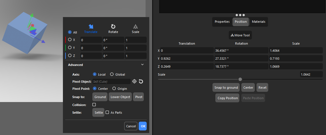

What happened to the little fly-out window that showed the distance or angle when you moved the part? You could simply move it and then fill the distance in that you wanted. Now you need to look and see which value is changing the most. I loved that relatively recent feature and now it’s gone!
Also, I second the frustration at the problem of not seeing a distance or angle when moving multiple parts.
We are going backwards here.
Hey guys, I guess it’s a new way of “Move Tool”. :face_with_monocle:
When you move, rotate, scale an object, you can find its original numbers that you have changed under the “Scene” “Position” “Move Tool”.

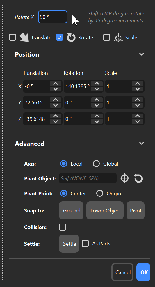

I figured out the fix!
Uninstall the trash that’s 2024.2 and re-install 2024.1… So much better!
The small fly-out is back and my part doesn’t teleport to weird places when I simply try to put 90° into the X rotation box.
Here’s a few of the other things that were happening. If you move more than one object all of the move dimensions are blanked out in both the Position boxes and the new move boxes. This is extremely frustrating since the older method above would still show you the distance moved, and you could override it with a typed in value.
On the new move tool I pulled the green arrow and the blue box changed value not the green. I then pulled the blue arrow and the blue box changed.
I tried rotating an item with itself as the pivot object. I pulled the red circle and rotated. The x box showed the angle but 2 of the translation box values changed. The part rotated as expected even with the other values changing. However typing 90° into the X rotation value caused my part to rotate and fly off in a diagonal direction. Zeroing out the translation values didn’t return the part to the proper spot either.
